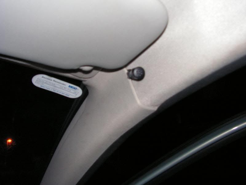

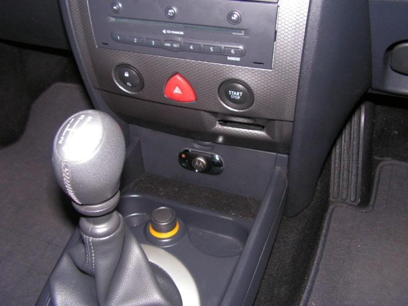

All fitted, if anybody is interested:

It's completely hidden, apart from the little mic and control panel not a cable in sight and it goes through the car speakers and mutes the radio. It connects when I turn the car on and disconnects when I get out. If I ever want to remove it, I can just replace the little plastic panel it is stuck to and remove all the cabling too.
My visorblade II I had before was excellent but so is this, without the bother of charging it or doing anything except getting into the car.

I have a very similar install except my controler is next to the headlight hight adjuster
Couldn't quite reach it safely for voice dial on bottom panel
But it does look good there

That was my second option :)
