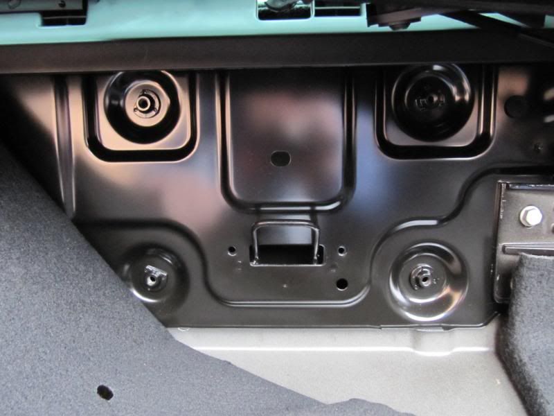

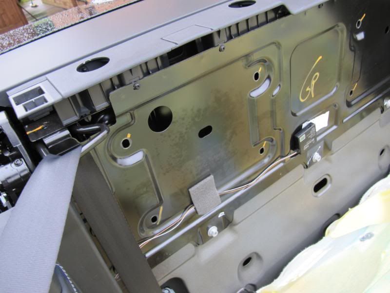

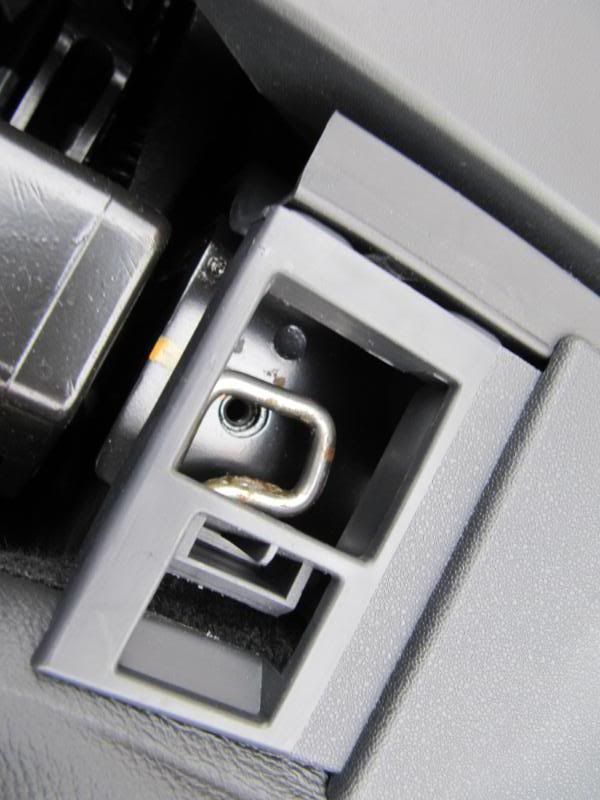

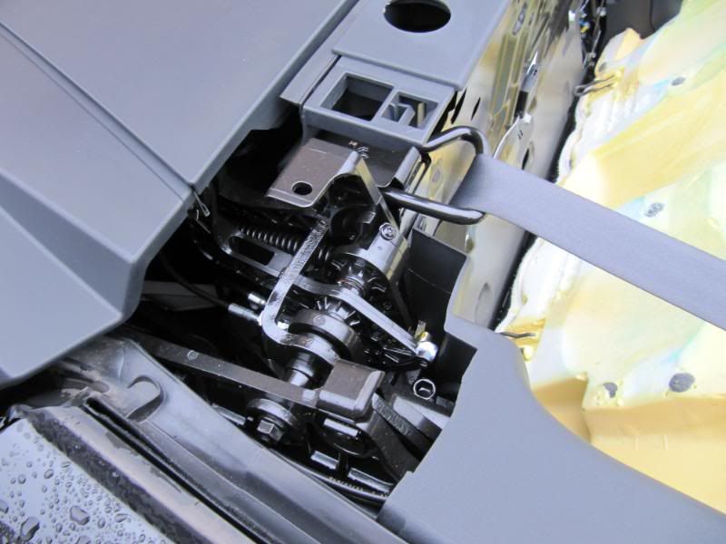

I can confirm that they arnt standard. I took mine out today. Quite easy to do once you know how. Just 4 bolts behind the rear seat.
In case any of you want to know how to take them out.....
I took back covering in the boot and could see 4 bolts which looked like they went right through, which gave me the idea that they were fixed
The Bolts were fastened behind the rear seat, so I have to take the back seat off first, with mean removing the plastic edge so I could get the the screw thatfastened the rear seat in.
It has been taken out in this pic, but you get the idea as to where it was
I simply undid the 4 bolts which you can see were located where the 4 paint marks are, then they just lifted out. Job done
I will update when I finaly get the hoops and fit them in

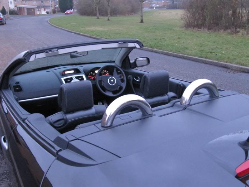

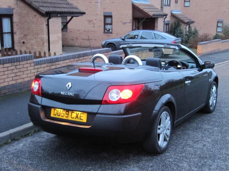

Yes, look at the photos I uploaded, see where I have shown the 4 bolts, they go right through with means they are fixed. How is anything going to raise when it has 4 blots in it? Answer is it wont, so just follow the pictures and you will soon see if they are the type that extend or not.

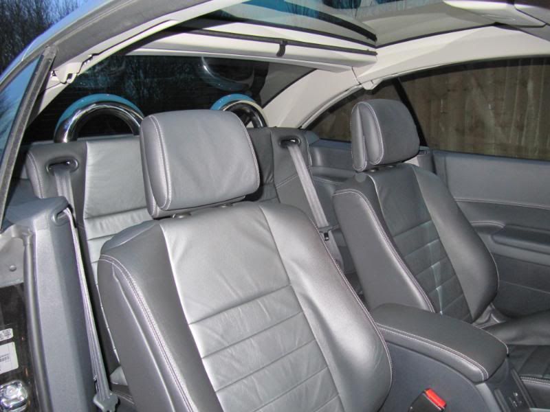

Anyhow, they arrived today and I fitted them nice and easily, fitted very well for a non Renault made aftermarket product. You all can decide if you like them or not. Im quite pleased.
And this is just one of the car taken on the weekend pre chrome hoops but without standard ones
