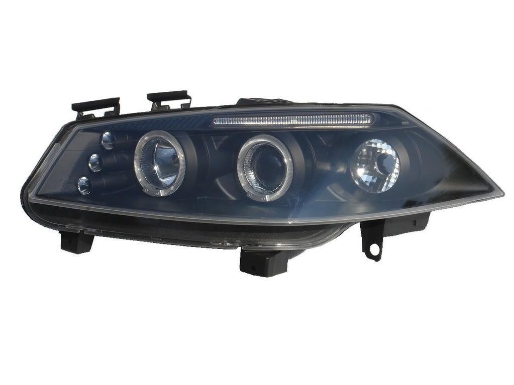

I have fitted HIDs to my Meggy... but in order to do so you need legally:
1) New Head Light Enclosures (they have to have a projector lens see photo bellow) and be auto levelling.
2) To fit washers for the head lights.
Others:
3) HID bulbs and ballasts.
4) A Relay
Of course you can just add in HID bulbs and ballasts... but the glare is unbearable, Causes problems for other drivers due to the light pattern and won’t (shouldn’t) pass MOT.
O and its a full bumper off lights out job.
One other thing Xeon Bulbs and HID (High Intensity Discharge) bulbs are two totally different things. One difference being the latter needs close to 22Kv (22,000V) to operate, thus the ballast, they shouldn't be confused.
These are the Enclosures I used.
