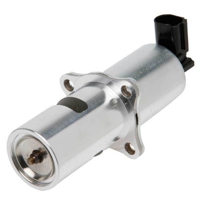

Re: Engine vibrates on idle plus crap mpg
Postby Bertisport » Mon Nov 11, 2013 12:12 pm
I've got a similar issue, mine vibrates when i pull up at the lights when the car is cold, but seems to get better when it warms up. My economy has nose-dived recently, was gertting mid fifties(lots of motorway ) but its now late 40's I know the cold would take some off but not that much!
going to throw some injector cleaner through it and clear out the egr.
Becarefull on EGRs there appears to be two types, the cylinder type from the MK1 DCi (£50)
and a weird multi lobe version on other DCIs (£150+)

well i just drove out at lunch time and it didnt vibrate but then it happened 10 mins later after driving.... mines the one in the first pic, just a mystery, now what i did notice when i took out my egr valve, one of the threads on the bolts was damaged, so the thread going into the casing was damaged too so i had to put a few washers on the bolt and nipped it up, im just wondering is any air getting in... doubtfull though
