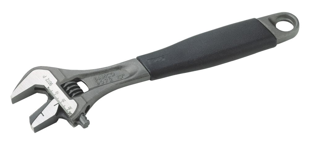

Those are easy to replace. Turn the steering to the full lock, grab the joint housing of the rod with some tool and turn it gently. Careful, it is possible to damage the rack if the thread is overly tight. In my case, it wasn't tight at all. Put it back with a threadlock.
I used the replacement kits made by TRW, they come with everything including the rubber boots. I used this wrench to grab the joint (the toothed jaw). The space is limited, so I recommend this one.
Bahco 9072P Rev Ergo Adjustable Wrench 10"

AlexB wrote:Those are easy to replace. Turn the steering to the full lock, grab the joint housing of the rod with some tool and turn it gently. Careful, it is possible to damage the rack if the thread is overly tight. In my case, it wasn't tight at all. Put it back with a threadlock.
excellent thankyou doing them satuday thanks all for the replys cheers phil
