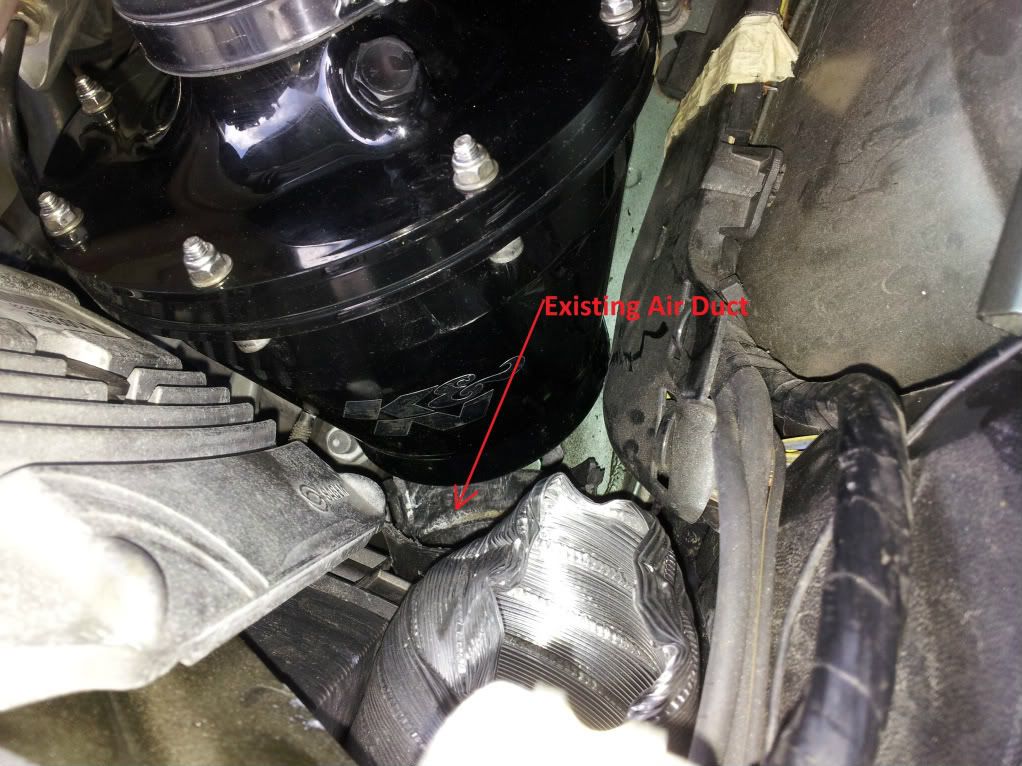

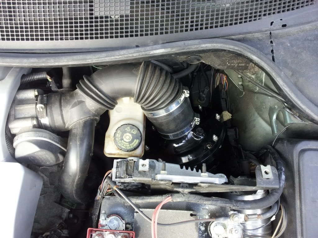

Factory airbox is a bit of a pain to remove in that you need to remove the battery, battery plate and ECU but fairly straightforward. On the K&N website they suggest removing the factory fitted ducting which means getting under the front of the car, etc. but I didn't bother. My Apollo filter is nicely wedged into the space where the standard box was and the inlet rests on the factory ducting under the battery so gets a good cold air feed from that.
The only other thing the mention is that, with a 57i kit, you get a silicone hose extension that runs from the carb to the filter but with the Apollo you don't so you will need an adaptor to attach it to the factory pipe where it would normally go into the standard airbox. This does mean that you retain the existing setup for all the additional pipes and stuff and i've found that it holds everything nicely, albeit a bit of a bodge job due to the fact it all came off my L200 Warrior and I didn't want to spend more money really
Here's a picture of it as it is now (my tweak it when the weathers better):
And a closer look of the positioning:

Wow. Looks pretty cool. Sounds like a lot of work to be honest but the results I bet was worth the effort. Might hold off on doing that for the moment and see how the car does with just the K&N filter. So far I am quite happy with it and I reckon, there is not going to be much of a performance gain with an induction kit. Or am I misinformed?
Thanks a million for the pictures and the reply. Really appreciate it as it puts things into perspective
