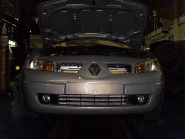

Postby Sebax » Fri Jun 10, 2011 4:33 am
Guys, just a little update; i bought a racing Radiator, i have to make a few mods to fit it in:
I think we are close to boost!

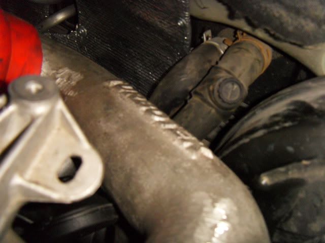

Well I have a big udate. The car was taken yesterday to the shop where all the piping is going to be made. I has some parts mounted like the Intake Manifold (we could not buy the Clio 182's manifold, so we mounted a Clio 1.6L one), cast exhaust manifold, Turbo, Intercooler and the new radiator.
At the new shop:
Mounted Radiator and Intercooler:
Cast turbo piping:
