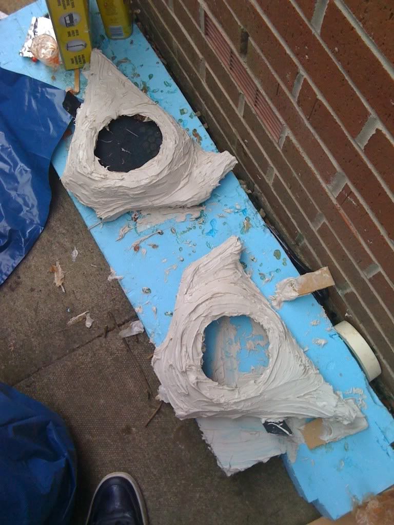

ive started to make my own, copying the style of the german ones, pics to follow
Re: 16.5cm speaker in front door panel.
Postby joeishmather » Sat Sep 18, 2010 3:46 pm
waiting for it to dry, then lots of sanding!lol
thinki may cover them in material rather than painting tho as i cba to get the finnish smooth enough and good enough to achive a decent paint finnish!lol

Postby joeishmather » Tue Sep 21, 2010 7:45 pm
given up!lol
cant get the shape right, n then if it does look ok the others odd, or the other way round! think if i was going to do it id make it out of something really softish, then do a vaccume form of it. cant even get the speaker to stay in as it was before, how have you got on with yours? i think i might have to get the whole door pannel off to get the speaker back in securely, dont think thats all that easy :-(

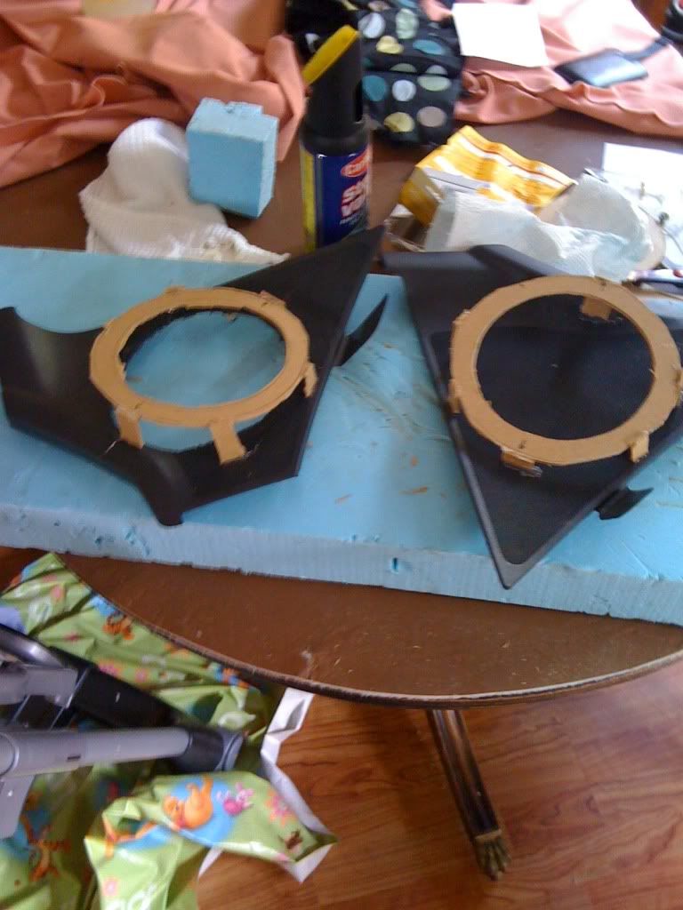

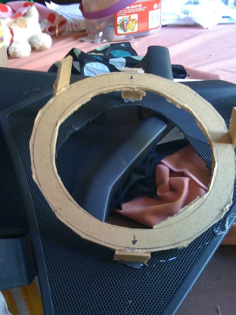

Yo! 1 migraine and 12 hours later I think I went a little over the scheduled time... but I did the job and it sounds epicly better.
I see what you mean joeishmather and thats what I thought. Although my speakers where the identical to the ones in the photos I had problems with the window going down on them so I just added another piece of plywood to mount them higher and its done :) You have to move the window motor further across and cut a sh1t load of pointless plastic from the back of the door car to get it to go back on but its worth it. I used some dynomat although I wish I could afford more dynomat I used some acoustic tiles from my studio.

how deep roughly are your speakers, and also have you put a larger wooden panel and the n a ring to lift it further from the window?
also how did you go about removing the door panel?

Postby Kylegypo » Fri Sep 24, 2010 2:12 pm
It's just one layer if plywood and then a ring to avoid the window. The Door card comes off with 1 screw behind door handle, take out the door pocket and there's another screw there. Then there are 2 more under the cover of the big handle. Most things just unclip and pop out. Be careful but also don't be scared to use force.
