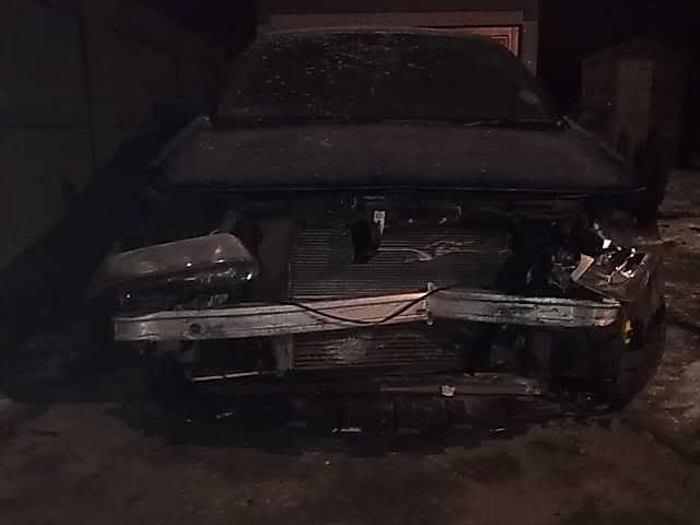

hello new to forum had car a week and someones ploughed into it, anyone know if this is a write off? so far i can see it needs wings/bonnet/slam panel/bumper/lights/radiators
car is a 2006 1.5 DCI dynamique
Thanks

Insurers write off cars according to the level of damage. There are categories from 'It will buff up' to 'never allowed back on the road'.
The photo isn't too clear. Parts of the structure are designed to crumple - that is why there is a 10mm gap between the radiator sub-frame and the rest of the car for example. When these areas are inspected and a reduced gap found, but no touching metal, you might get a 'pass'. Other aspects used to be how out of shape the car is when measured in a jig. The aluminium front bar is for pedestrian safety, but given that it is snapped straight through, you may be into a grey area.
Obviously there is an economic angle. To sort that out (at an approved garage) may cost more than it the car is worth - particularly when you take into account all the bits of trim.
One outcome is that the insurance company will write the car off as damaged, but not so much that it is banned from the road. You can then buy it back from them for peanuts using your claim money and fix it yourself (cheaply). I wouldn't have thought it was worth doing though.

Depends on insurance company, I'd of said yeah write off. Do you know the insurance value of the car? Generally they'll send someone round to deside n then they'll pay out n take away the car, sometimes leave you with it, a car of mine got wrote off, insurance bloke came round told me it was a write off, do what I want with it n off he went. Sold the car for scrap n insurance gave me monies for a new car! :-) was good as I hated the car I had!lol

depends on value of car against cost of repair. i'd say it's a write off though.

bonnet will not open aat all radiator and intercoller knackered and passenger chassis legis bent dont think its looking good damn only had car on road for a week, they have gave me a slow 08 punto in the mean time total nightmare, really hope it gets sorted

If it has A/C, is that breached too?

i would say gone worked in a bodyshop for a while

yeah A/C gone too just waiting on it getting picked up really liked it as well
