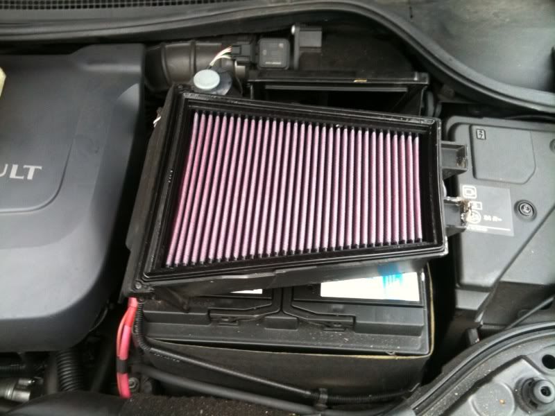

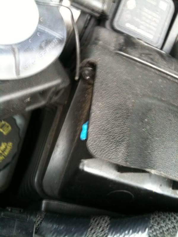

Well i found this post:
mintyman5 wrote:hi , i've just replaced my megane 2 dci filter for a green cotton one , i presume yours is the same as mine , i removed the battery cover , then the two screws holding the filter housing in place then you just pull it a little towards the front of the car , then it should slide out upwards , easy peasy. :D
so decided to go out and have a crack at fitting it myself, not something i would normally do :lol:
I started by unscrewing the two screws on the air filter housing (bloody tight fit)
then gave it a good pull and slid the housing upwards removing the filter and replacing it with my K&N panel filter
then i slid the air filter housing back into the original slot and tightened the screws back up, leaving it look like it was before the totally OEM look 8-)
Cheers mintyman5 :cool:
