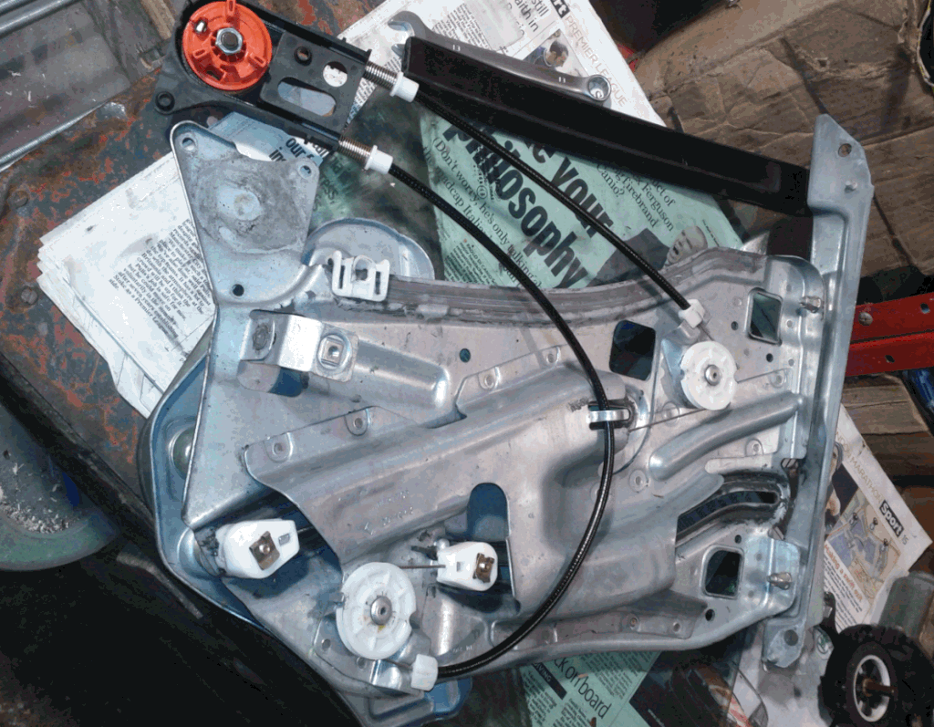

The completed cables in place
Note how tightly compressed the tensioning springs are. After trying for ages to get the cables on, I ended up making a clamp to hold the springs compressed -

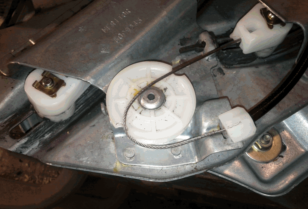

That then allowed me to get the cable to this point, where I could then turn the pulley by hand (using thick leather gloves) and get the cable on the last bit -
Cable on pulley
Cable on pulley

Replaced the cables OK today, no problems at all will try to find time to write something up but pretty busy at the mo. I'm guessing a job that cost me £10 would have been £650 to £700 in a Renault garage

I didn't use the springs that came with the cable kit as they were far stronger than the originals so I removed the originals from the old cables. I had to pinch in the first coil of the old spring so that they stayed in place on the new cables as they were a slightly loose fit and as you know when installing the cable the last thing you want is for the spring to move around during installation.
Having first wound the cables onto the motor drum I installed them by attaching the first cable to its mounting post (while keeping both cables slightly taught to keep them in place on the drum) then pulling the second cable end by gripping the white nylon block by hand and slipping it over the other mounting post.
It actually went much better than I thought it would, It looks like a really big job to do but it really isn't that bad assuming you have reasonable mechanical skills.
