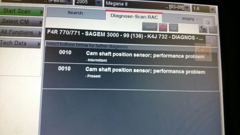

Hi all, had a problem with the cc today, 1.6 16v vvt, engine cut out every time my wife took her foot off the power, so, would be unable to get home tomorrow, so I told her to ring our recovery, when the guy arrived he plugged her in to his computer (the megane not my wife)and it came up with cam shaft position sensor: performance problem,
Imagehe told my wife as long as she keeps.the revs up.it will get her home no problem, but he also said that this is an easy repair, all I need is a 13mm spanner, and the part should only cost around £20, if this is correct, I'm going to do it my self, it would be my first ever repair, would any of you say this is ok for me to do as my first job.
