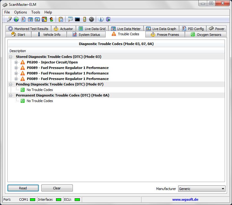

I plugged in my OBDII and brought up the following codes , but it is not a clip system :(

OK took that car last Friday to be scanned and tested.
And came out to be Injector No1 (next to the battery) It did not pass the test with flying colours.
Also they did a diesel quality test and there are no aluminium pieces in the lines coming from the pump so I am safe in that scenario :) :)
I looked online and I have found reconditioned injectors for £95.00 + VAT with 12months warranty and me sending my old one back.
I will get one of those and have the garage have it installed and coded in the car :)
This should fix my problems.
