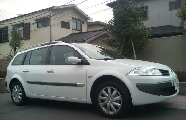

Dear sir,I want to know the common-rail systems on my car.
Because my car is not sold formally in my country, I cannot obtain the information from a dealer.
I think my F9Q804(Megane) engine to be the 1.9dci F9Q engine series.
The parts number ;
@fuel pump-Bosch#CP3S3/R70/20-789S
@injectors-unknown #Renault 82 00 389 369
@Computer-Bosch #Renault 82 00 549 211/82 00 549 228
But I want to know whether the maker of the injector is Siemens or a Bosch,and type of Solenoid or Piezo-electric.
And whether operating pressure is 1600bar or not....
Thanks,
