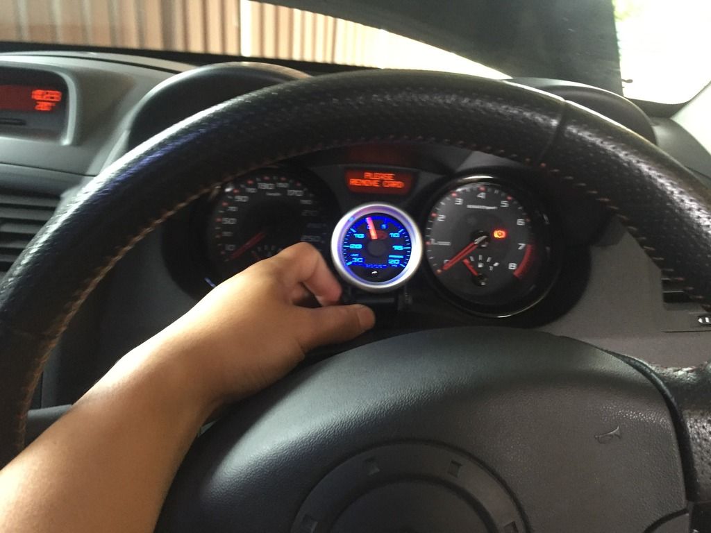

URL=https://s666.photobucket.com/user/Stan_Tran/media/Mobile%20Uploads/image_zpsqykko2jh.jpeg.html]Image[/URL]i
Will be mounting right here. Wiring done, vaccum hose not so easy.

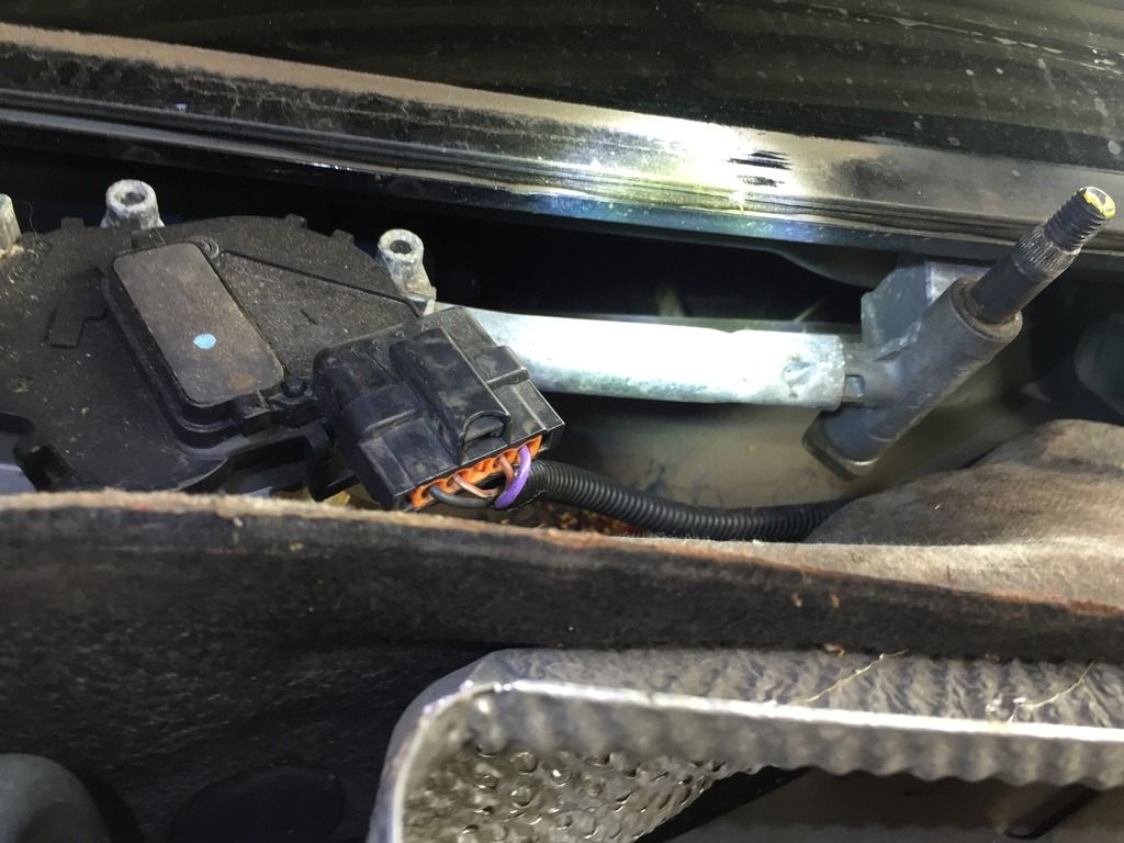

Have tried poking a snake down air vent but luck coming out near foot well pedals.
Pulled cabin filter out, large leaves came out....if large leafs can come in why can't I poke a snake thru this???
