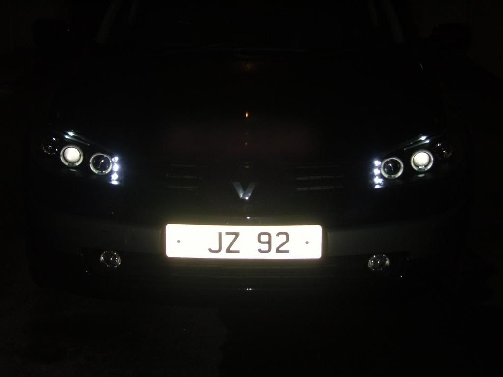

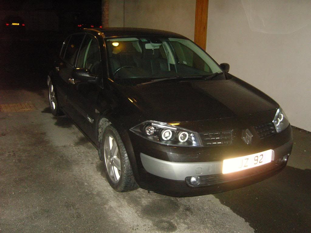

It is easy done, here are my results after less than 1.5 hours work.

Any pics with the lights on mate?
2005 Megane Sporthatch 2.0 VVT Dynamique Extreme Blue
Re: Ftting Angel eyes
Postby Paddy » Tue Jan 20, 2009 6:25 pm
busternlouie wrote:Any pics with the lights on mate?
There on, well side lights... Ill take a few better one show HIDS.

Ulrich, they look pritty neat matey!!! :cool:
how is the beam pattern etc... when it projected onto the road?? same as orginal.....??
shame they dont do them, well i havent seen them for the facelift megane :-(

Andy_CC wrote:Ulrich, they look pritty neat matey!!! :cool:
The beam pattern is perfect... I had them aligned properly.
With the HIDs the light is incredible, at least three times as bright and travels much further down the road. My full beam doesn’t make much impact now... not that I could see it being needed any more.
