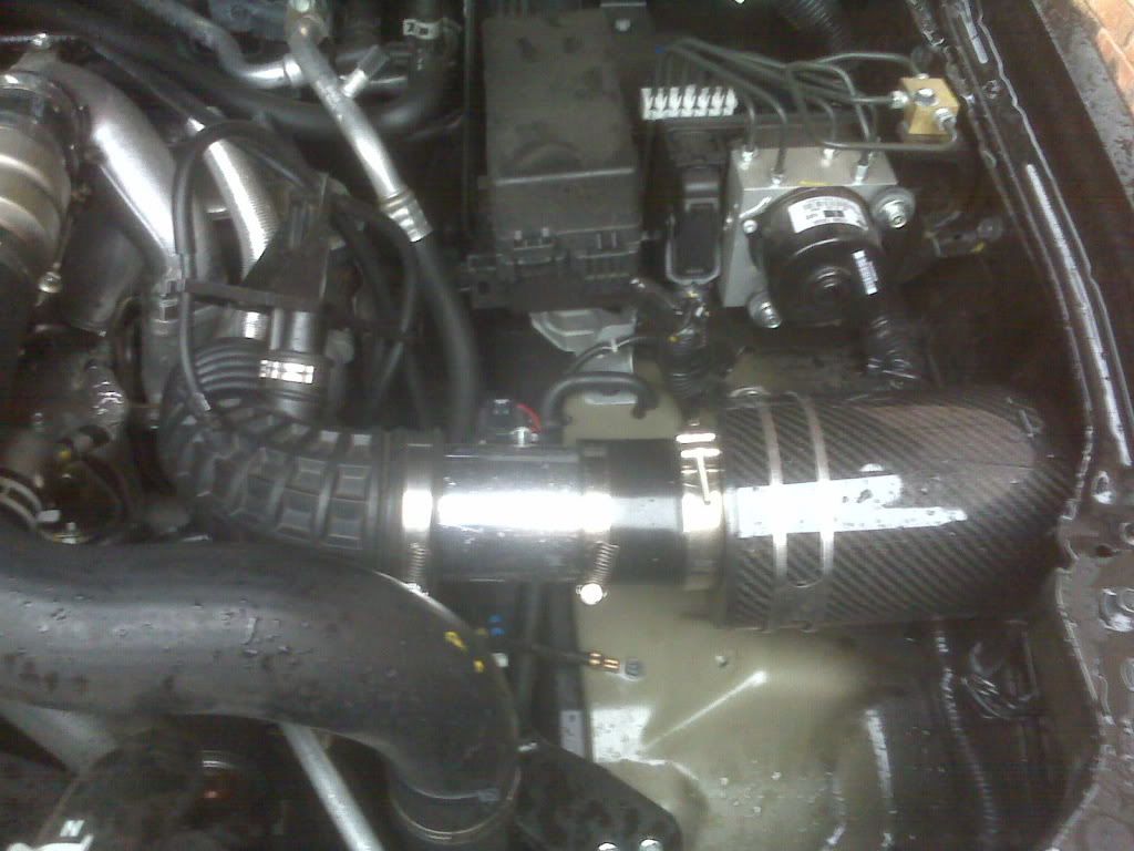

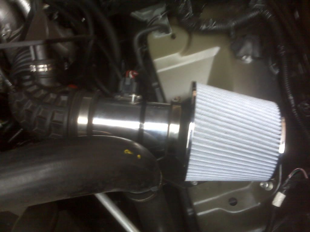

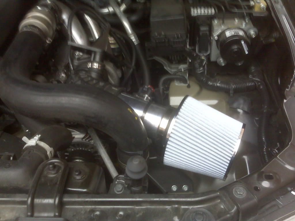

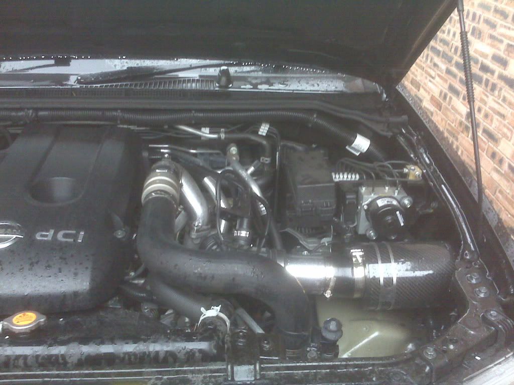

Design your own. Im going to do it for my megane CC 1.6 when the weather gets warmer
But ive already done it to my Nissan Navara 2.5 DCI.
Parts that ive used for the NAVARA (but it will be simlar for the megane i recon, just measure the diameter of inlet pipe)
1. Alloy Straight Polished air filter Pipe (300mm x 76mm) from ebay approx £11
2. Universal sliver cotton gause cone filter from ebay for £5
so for £15 i had this
But with the Nav having a big turbo and the inlet practically straight onto the turbo it was WAY TO LOUD!!!
so i went scouting on ebay again and found a universal closed/forced carbon induction filter (simlair to the BMC unit or the piperX viper) for £35 and bolted that onto the end of the alloy pipe, its a lot quieter, but with a nice growl, and it dumps to lol!! ID PROB GO FOR THIS SET UP ON THE MEGANE AS THE STANDARD AIR BOX IS AT THE BACK OF THE ENGINE, hot air and all that...............
