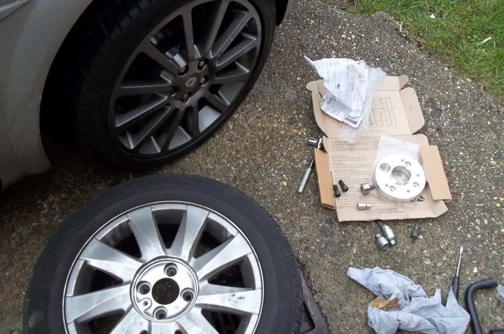

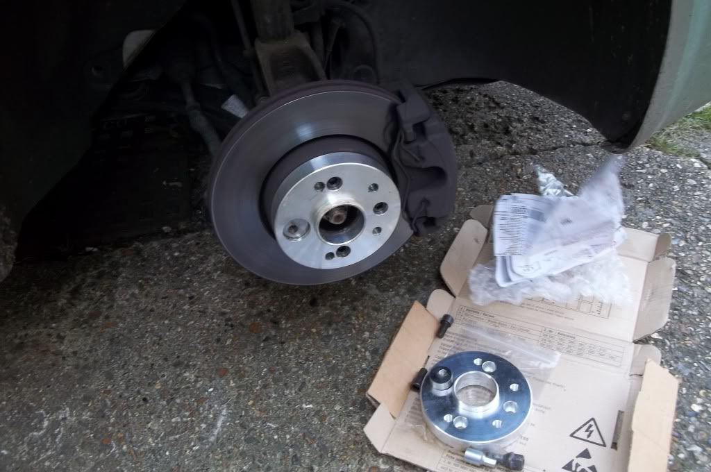

Hi thought i would share what i've found.
It seems to be very hard to find wheel adapters to make 225 wheels (5 stud 5x108) fit the standard megane dci (4 stud 4X100)
Here's mine and the site ive got them from.
https://i1271.photobucket.com/albums/jj6 ... er/029.jpg
https://i1271.photobucket.com/albums/jj6 ... er/028.jpg
yes this is only 2 adapters for £160 euros so for four £320 plus £15 delivery but i think well worth it, if you want a good replica.
https://www.concept-wheels.be/shop/cart. ... 83935c7982
They fit very well, but i have taken off for now until ive got the full 225 kit fitted.
once my cars complete i'll post the full journey.
hope this helps.

Looking good mate!
What size/width and ET are the 225 wheels?
How thick are the adapters?

sorry no idea what the ET is. Maybe someone else could help?
These wheels are 18's and the centerhole is 60.1 same as the car.
these adapters are 20mm thick which sit really nice.
https://www.concept-wheels.be/shop/produ ... HOLES.html
