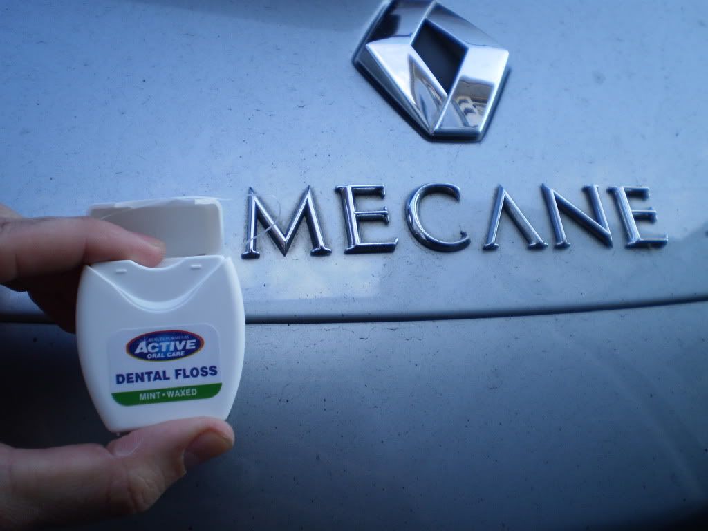

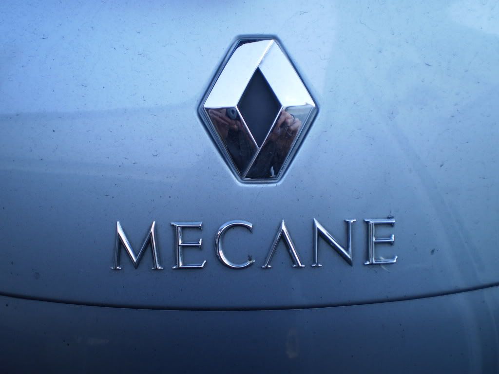

Here's a step by step guide to tidying up her ass and safely removing the boot badge for a cleaner, crisper arse end

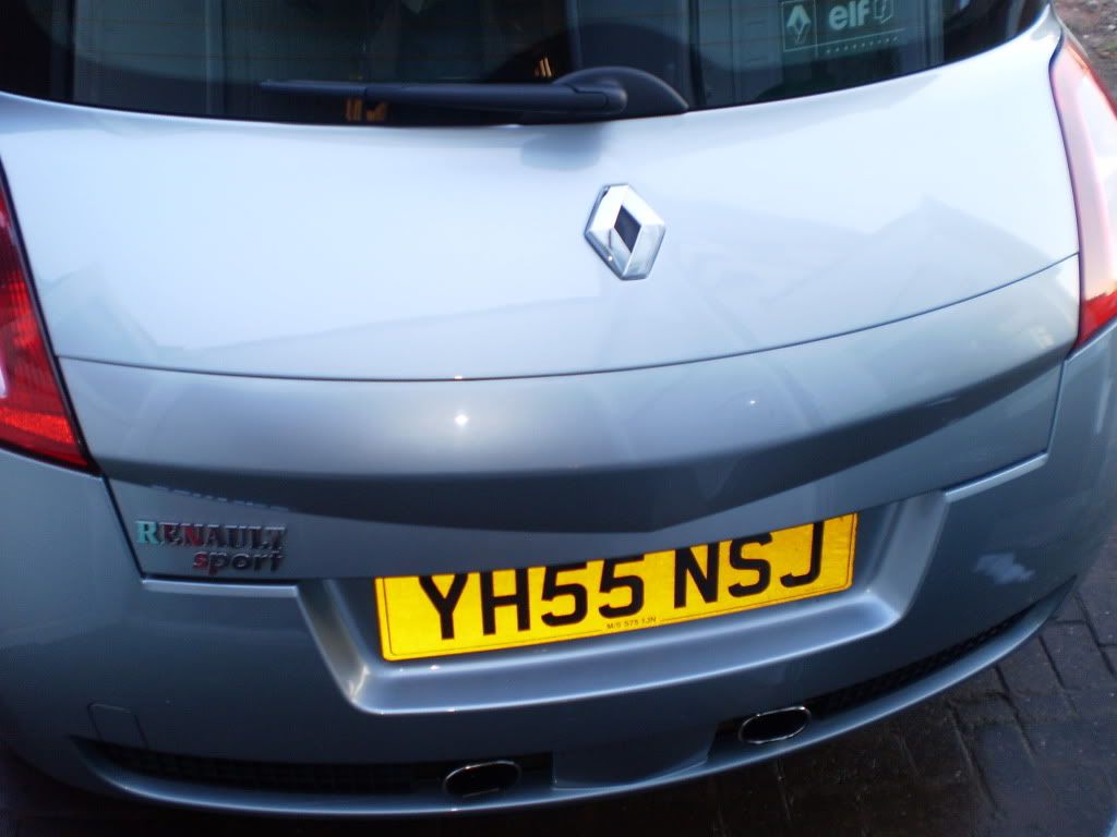

Here's the standard boot badge looking tired & dirty!

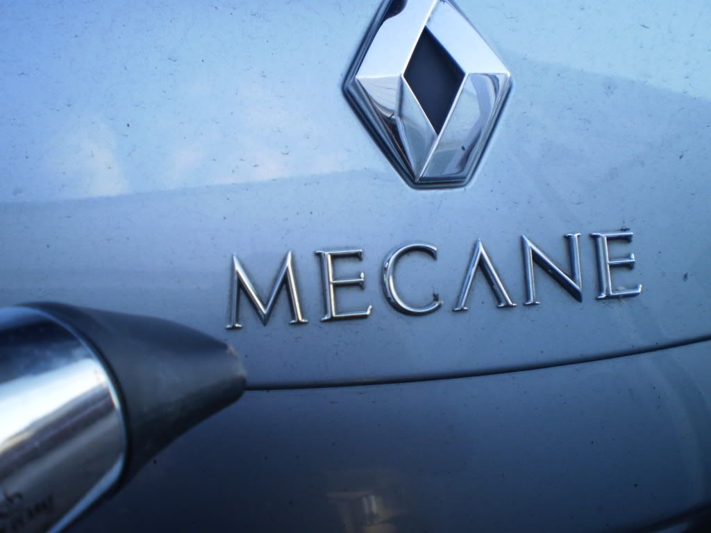

Apply some gentle heat with a hairdryer for 15-20 seconds

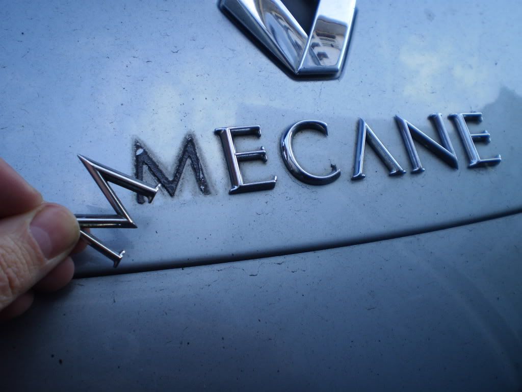

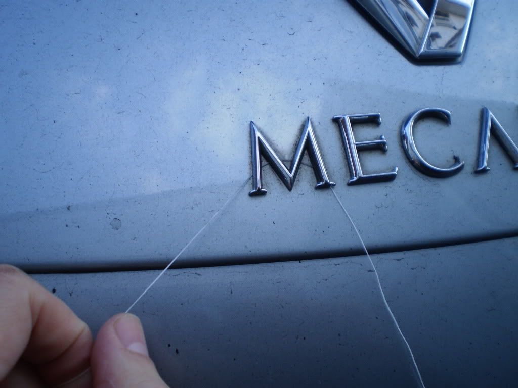

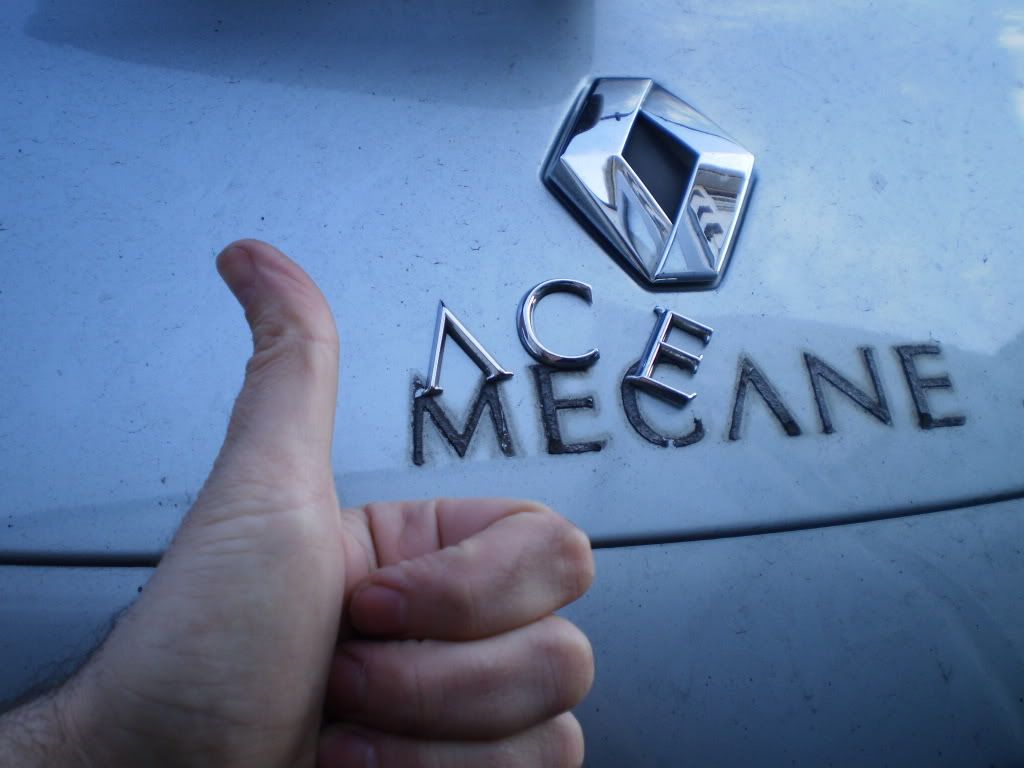

Dental floss or some fishing line will do the trick now! Slide it behind the letters and see saw it down until they pop off!

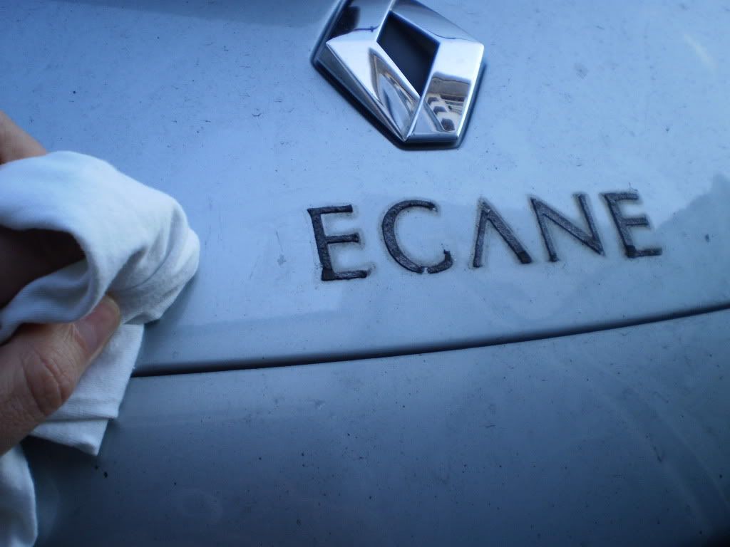

Get to work with some hot water and some turtle wax! The adhesive comes off in seconds!
Give it a good polish with a light cutting polish, i chose Auto Glym Super Resin Polish, worked a treat!

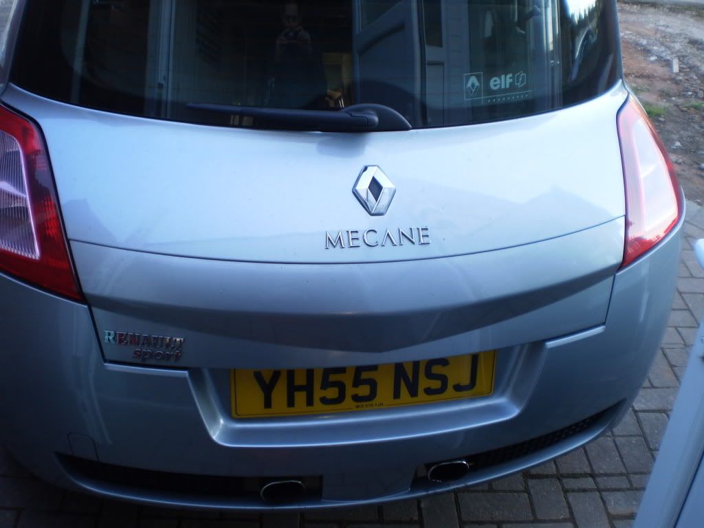

Finally an all over wash and a polish with a regular turtle wax to protect her clean new butt! Job done!
HOPE YOU LIKE THE END RESULT GUYS & GIRLS, I'M PLEASED WITH IT ANYWAY!

yea, the end fell of my G making a handy C! Seemed rude to waste it!

I've just joined the tidy arse club! The idea of using dental floss is genius.
- Just Passed
- Posts: 141
- Joined: Sun Oct 17, 2010 7:49 pm
- Currently Drives:: Megane 2.0Dci GT (remapped!)
Front & rear HEL brake lines, Uprated Alpine ICE - Location: Carterton, Oxfordshire
Re: De Badging - Removing the Megane Boot Badge
carlsberg wrote:I've just joined the tidy arse club! The idea of using dental floss is genius.
Fishing line also works a treat
