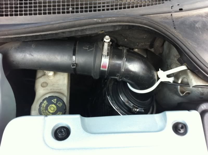

Well its a commitment really, you take the air box out, you aint getting it back in lol
Its an arse of a job, gotta take out the battery, ecu, battery tray, disconnect the air box then just yank it out!
The 90degree bend pipe i just put it where the pipe came from the back of the engine (normally that end would go straight in to the top half of the air box)

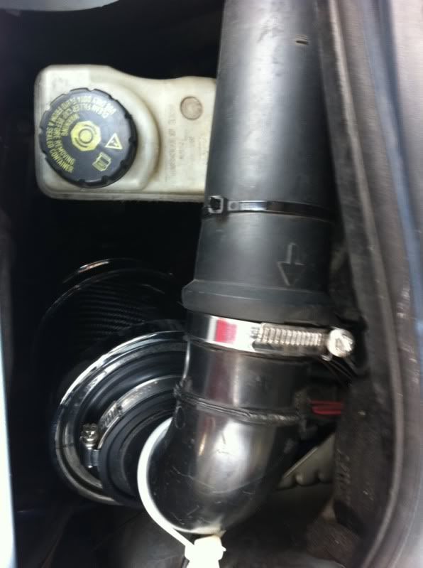

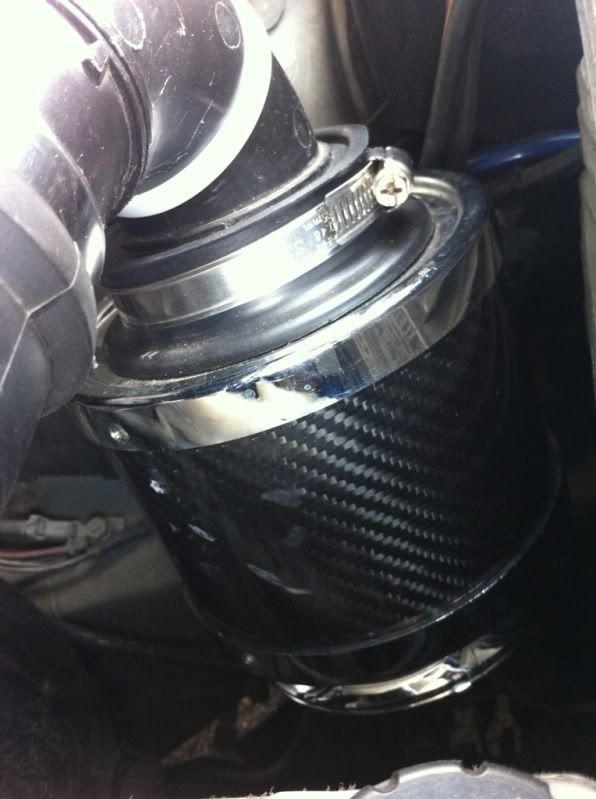

As promised guys

Hi, perhaps a daft question but where is the maf in relation to this.
Re: Has anyone fitted a K&N Cone Style Filter?
Looks well!
Mines different but, ive MAF at end mine.
Wher u get that 90o pipe?d

Yeah mine has the MAF at the end as well.
What the hell is a MAF lol?
The 90 degree bend pipe i cut of from another cold intake pipe as I could find the right diameter at the time but I'm sure Samco do them
Check out the progress viewtopic.php?f=13&t=13676

Yeah there wasn't one on there :-S so I guess that model doesn't have one or it somewhere in the back of the engine. I disconnected the box and put the filter in its place.

Ckecking your filter Pic there, the halfords in N. Ireland nver seem 2do fancy carbon filters!! Lol
Have u that filter hooked up2 the standard cold feed pipe??

The cold air feed blows towards it but havent got it connected yet as I have brought a massive carbon canister and air filter. So i am planning on a mad one!
