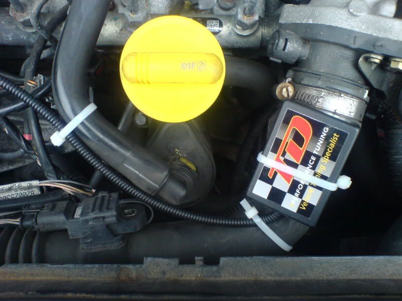

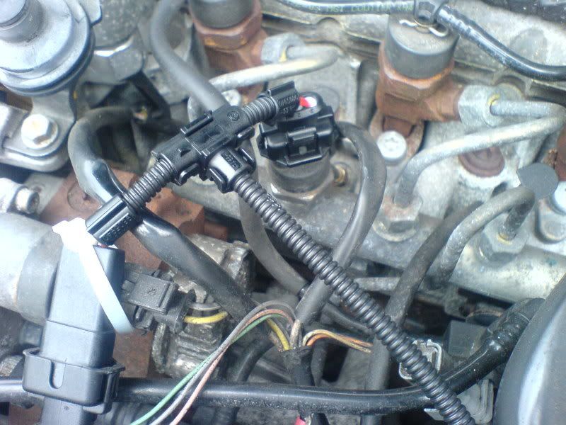

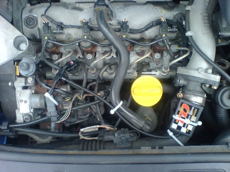

ordered a tuning box for my 1.9dci 120 yesterday afternoon from colin at tdtuning for the discount price of £120 and it arrived 8am this morning :cool: so here is a few pics of where to plug it in and where i mounted it (probably not the best place but its pretty secure) , im off to try it out now and see what its like..

done about 150 miles with it now and its good, does a few more miles per gallon definately, and overtaking is easier you can feel the extra torque , not as big a gain as expected but still worth it, no downsides at all , no smoke or juddering or any warning lights all good so far :-) would like to get dyno to see the real gain
