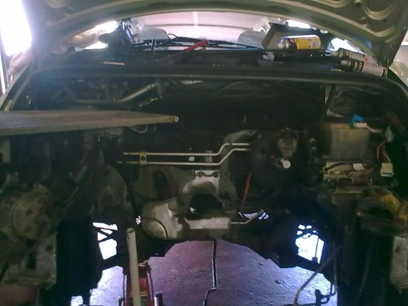

I got a Renault Espace not long ago and it had the 2.0, 16v engine.
Previous owner, a total dick, hadn't serviced it in 2 years, so the engine sounded like a Massey Ferguson on full revs ploughing a particularly difficult field.
Anyway, I knew it wouldn't last long so I decided to....errrmmm.....change it....a bit :wink:
I got a whole Renault Laguna from 1998 that was driving and was well looked after.
The Laguna?

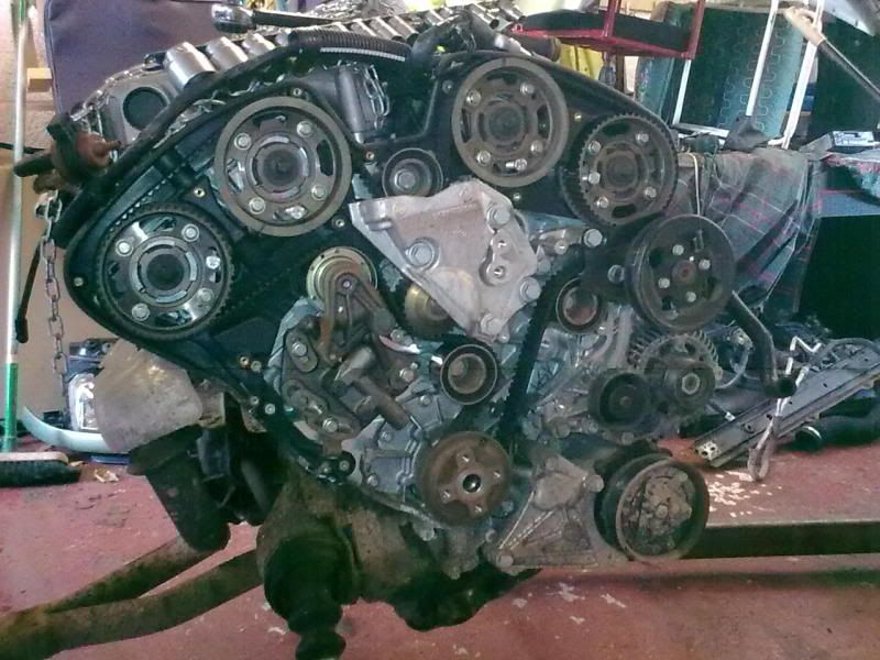

A 3.0 litre, 24v, V6 :rock
So I stripped everything I thought I'd need and took a whole day and a half removing both engines and all the gear.
Trouble is, those devious Froggies decided it would be fun to do it arse for tit :cry
I had to change the mounts (as you'd expect), then the hubs because the shafts on the Espace have the ABS pick up rings on the shafts, where the Laguna has them in the bearings, then I had to change the ABS plugs to sockets because the Laguna is back to front, then I had to make up an exhaust because the......you get the picture :-(

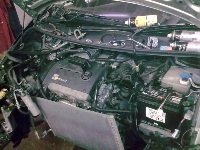

Anyway, it all went together and looks the tits :cool:

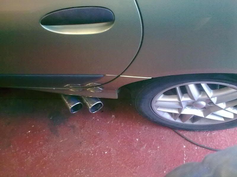

I even made side exits for the exhaust and they do look secksey :grin
