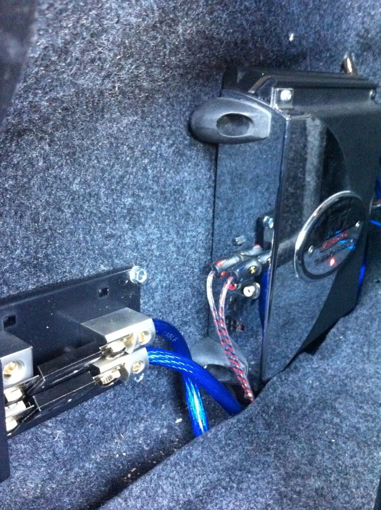

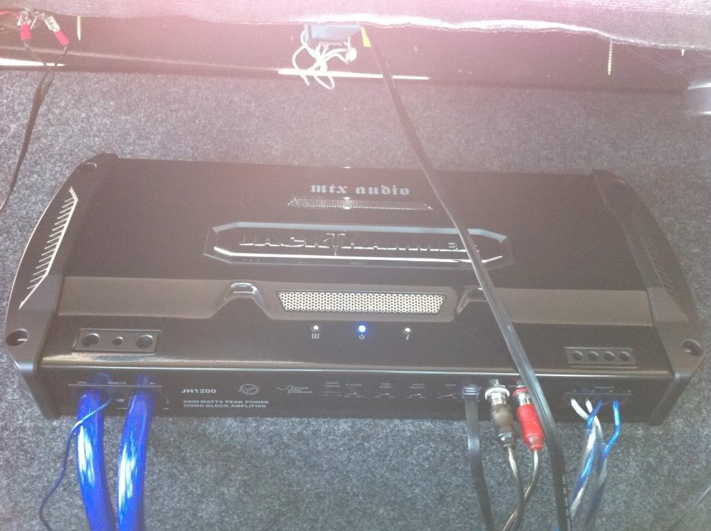

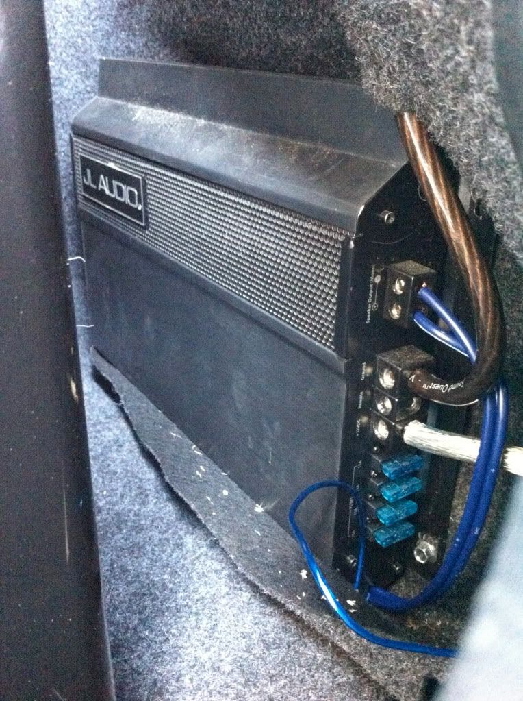

I have a huge ICE system goin at the minute, currently running 3 amps in the boot running door speakers, 6x9s and also a sub. i have 1/0 gauge power cable running along side the passenger side under the plastic mouldings amounst the other wiring, i would also recommend that you run your component wire along the opposite side of the car to avoid any interference, and yes u can get interference in sub bass sound. any other ICE questions just ask... heres a few pics of my car atm along with a video.
