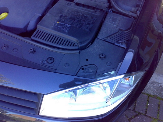

As you can see there is no way of doing it from here

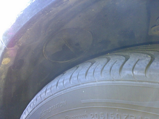

Here is a access cover in the wheel arch you can unscrew

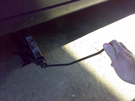

Jack car up with Renaults quality jack

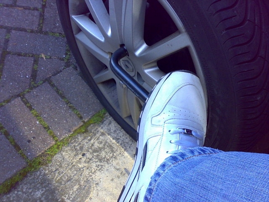

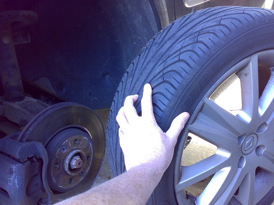

Remove wheel

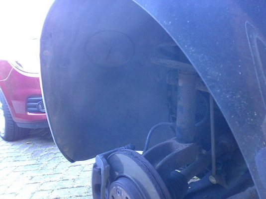

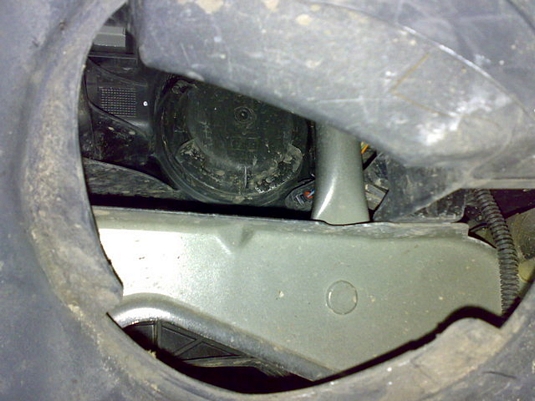

Thats better. Unscrew cover.
Unscrew another cover.

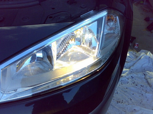

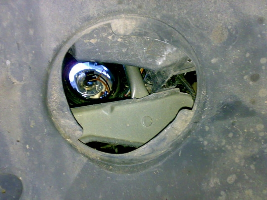

There she is. Pull the plug off the back of the bulb and push wire clip at the top to release bulb.
Now bulb replaced better check it works before i rebuild the car

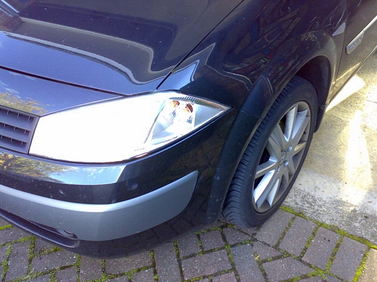

All done
Tools used - Sheet to kneel on (a cushion would be better), torch, locking wheel nut adapter, wheel brace, jack, and new bulb.
